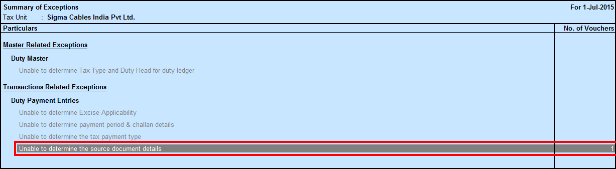

Unable to determine the source document details
Cause
If a payment transaction is recorded with Type of Payment as Arrears and the source document number and date are not specified, this exception will appear.
Solution
Enter on the exception:
List of payment transactions appear.

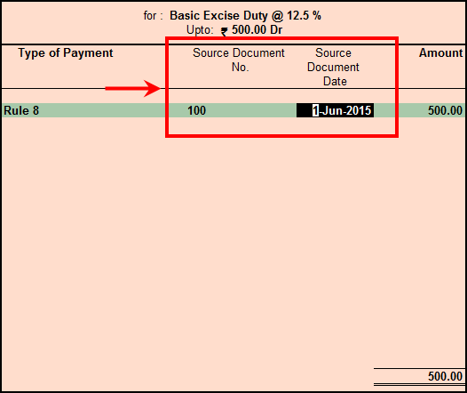

Enter on transactions to view the payment Voucher Alteration screen.
Press Enter on all fields till the Type of Payment screen is displayed.
Select Type of Payment , Source Document No. and Source Document date.
Accept the screen to rectify the exception.
