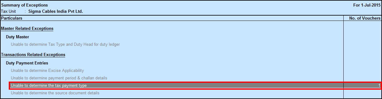

This exception occurs if the payment type is not selected in the payment transactions.
To resolve this exception
1. Press Enter on the exception.

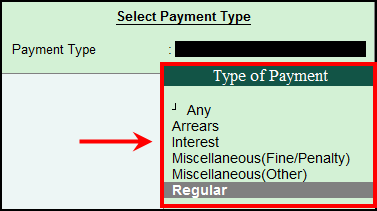

2. Press Space bar to select the transaction.
3. Click S : Set Payment Type .
4. Select the Type of Payment from the list.
5. Press Enter to save.
The exception is now resolved.
