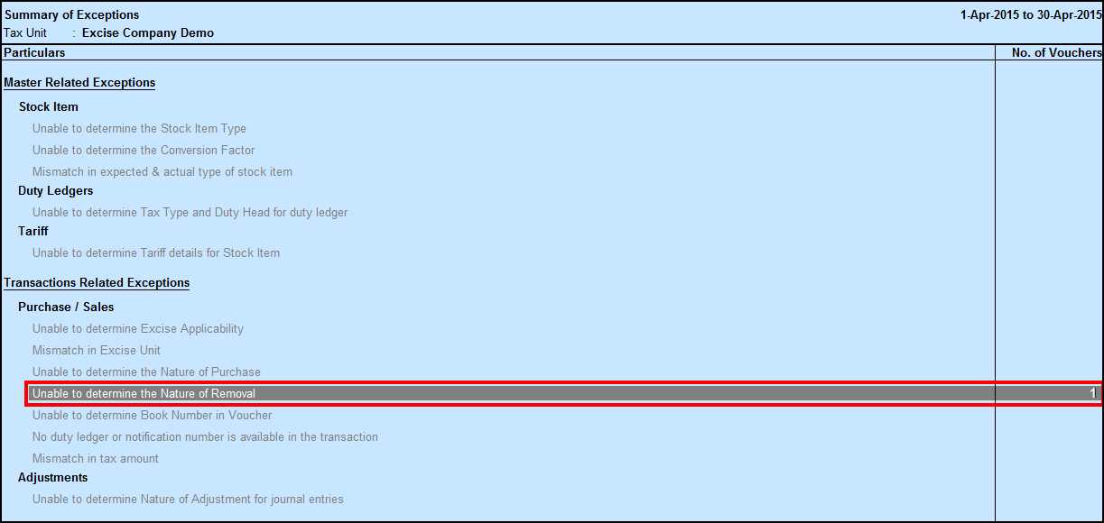

Cause
If nature of removal such Captive Consumption, Domestic, Exempt, Export, Export – Duty Chargeable, Removal as Such and Special rate is not selected in the transactions, this exception will appear. Tally will display total number of transactions for which nature of removal is not defined.
Solution
1. Enter on exception. The List of transactions appears.
2. Press Space bar to select the transactions.

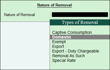

3. Press Alt + S: Set Nature of Removal . The List of nature of removal appears.
4. Select appropriate nature of removal.
5. Accept the screen to resolve this exception.
