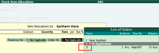

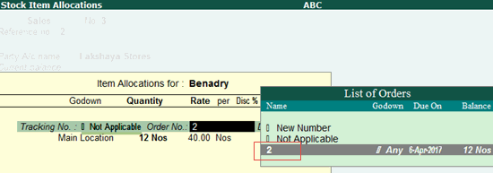

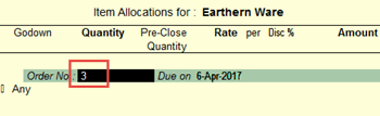

4. Record a Sales Order for two or more stock items. The Item Allocations screen for the stock items in a sales order appears as shown below:
Note :By default the Order No. is pre filled as 2, the user can change it.
5. Record a Sales Invoice for the sales order. The Stock Item Allocations for the stock items appears as shown below
Note: Sales order entries that were passed before enabling this feature will not be hampered.
