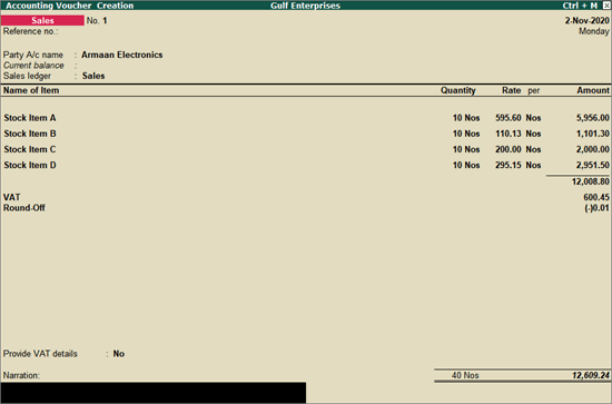

On calculating 5% VAT rate on the total taxable value of 12,008.80 , the VAT amount would be 600.44 . Hence, the invoice value would be 12,609.24 .
You can arrive at this invoice value by using the round-off ledger.
h. Select the round-off ledger. The amount appears automatically. You can change the amount to -0.01 . Now the invoice value appears as 12,609.24 , as shown below:
i. Accept the screen. As always, you can press Ctrl+A to save.
