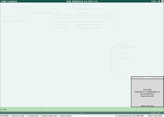

TDS Rate 'Payment to Transporters (Sub-Contractors)' does not exist!
Cause
This error appears while splitting a data when TDS nature of payment was predefined at group level and in later stage the group was altered by a selecting different primary group, unrelated to the TDS nature of payment.

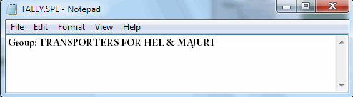

To identify the accounting group
1. Open Tally.ERP 9 installation folder.
2. Open Tally.SPL file in notepad.
3. Make a note of the group name appearing the Tally.SPL file.

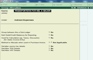

1. Go to Gateway of Tally > Accounts info. > Groups > Alter .
2. Select the group which was appearing in the Tally.SPL file and press Enter . The Group Alteration screen appears as shown below:

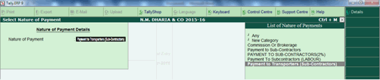

3. Set the option Set/Alter TDS Details? to Yes and press Enter . The Select Nature of Payment screen with the selected name of selected nature of payment appears as shown below:
4. Select the option Any in the field Nature of Payment and press Enter to return to Group Alteration screen.
