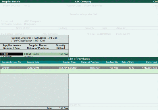

3. Select the godown created with the Registration Type Importer In the Destination Godown field.
In Supplier Details screen, the List of Purchases gets displayed for selection
4. Select the required purchase transaction
Note : Quantity Utilized shall be the complete pending quantity pertaining to the purchase reference selected and the same cannot be edited

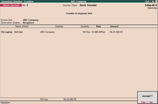

The completed Stock Journal voucher appears as shown below:
5. Press Enter to accept.
Note: If the quantity entered is more than the stock available in dealer’s unit, an error message gets displayed. Only after entering the quantity which is equal to available stock, the voucher gets saved. Occurrence of this error is possible only during manual voucher entry.

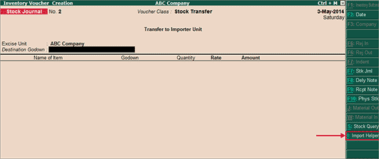

The dealer unit gets displayed as the Excise Unit .
4. Click I : Import Helper button to automate the stock transfer transaction.
5. In the Import Helper screen, select the Destination Unit from the List of Godowns .
● In From date field, the books beginning date gets displayed which can be changed if required. Purchases recorded from this date gets considered for stock transfer.
● In To date field, the transaction/stock journal voucher date gets displayed. On changing this date, the voucher date also gets changed.
The completed Import Helper screen appears as shown below:
Based on the information provided in the Import Helper screen, the closing stock of all the items purchased by selecting the Nature of Purchase as Importer prior to the date of registration as Importer, gets transferred to the destination godown.

6. Press Enter to accept the Supplier Details screen. The Inventory Voucher Creation screen appears as shown below:
7. Press Enter to accept.
