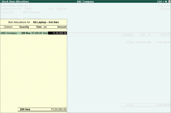

5. Select the stock item and in the Stock Item Allocation screen.
6. Select the dealer unit.
7. Enter the quantity and rate as shown below:
8. Press Enter to accept.

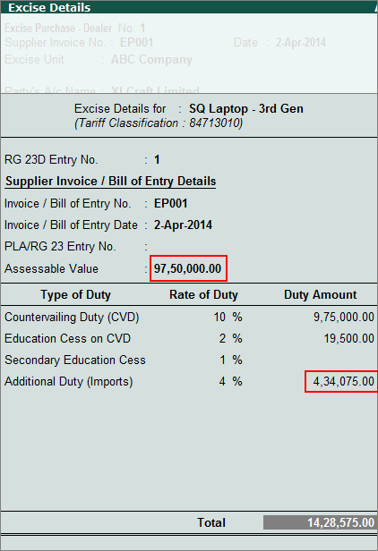

In the Excise Details screen, the RG 23D Entry No. gets displayed automatically.
Note: For the very first excise purchase invoice, the RG 23D Entry Number displays as 1. If any other number is to be displayed, it has to be entered manually. For the subsequent stock items selected in the same invoice and for each item selected in subsequent invoices, the RG 23D Entry Number gets increased by 1 and displays automatically.
PLA/ RG 23D Entry no. need not be entered in case of goods imported
9. Calculate the Assessable Value manually and enter amount as sum of purchase cost and customs duty (30% of purchase cost)
10. Calculate the Additional Duty (Imports) .
11. Enter the value manually (defined % on [Assessable Value (Purchase cost + Customs Duty) + Countervailing Duty (CVD) + Education Cess on CVD + Secondary Education Cess on CVD + Education Cess on Customs Duty + Secondary Education Cess on Customs Duty)
The completed Excise Details screen appears as shown below:
