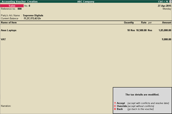

6. Select the common VAT ledger. The ledger must be grouped under Duties & Taxes in which the options:
Type of duty/tax set to VAT ( CST in case of interstate sales).
Percentage of Calculation (eg 5)? set to 0.
7. Press O to override the default tax details.
