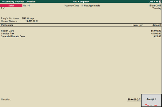

10. Enter Narration , if required.
The transaction with foreign currency appears as shown below:
11. Press Enter to save.
