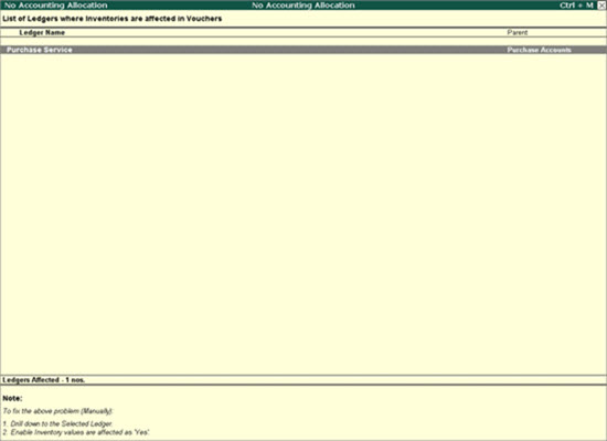

To verify the data of a company before splitting
1. Go to Gateway of Tally > Alt+F3 > Split Company Data .
2. Click Verify Company Data .
3. Select the company you want to split in the Company Name field of Data Verification screen.
4. Press Enter to accept.
5. Select the mismatch type to make the corrections. For example, No Accounting Allocations .
6. Press Enter . All Ledgers with the mismatch are listed.
7. Select a ledger and press Enter to open the Ledger Alteration screen.
8. Enable the option Inventory values are affected? .
9. Press Ctrl+A to save the ledger master.
10. Similarly, make the change in all the ledgers listed, and proceed to split the data.
