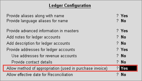

ABC Company wants to purchase stock items for cash and appropriate cost based on the quantity purchased. For this, ABC Company should enable the option Allow method of appropriation (used in purchase invoice)? in the F12: Configure of the ledger master, as shown below:

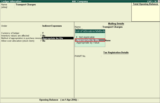

Under the option Method of appropriation in purchase invoice? in the ledger master, ABC Company can select Appropriate by Qty in the expense ledger as shown below:

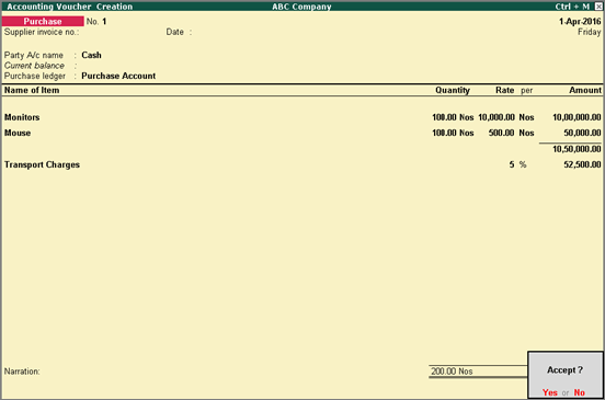

ABC Company then records a purchase voucher for stock items, with Transport Charges, based on quantity, as shown below:
Note : If a purchase ledger is not available already, press Alt+C in the Purchase ledger field to create one.

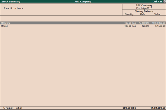

ABC Company can verify the appropriation of cost based on the quantity of stock items purchased, in the Stock Summary report, as shown below:

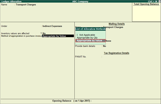

Similarly, for the same purchase voucher, ABC Company can also appropriate cost to stock items based on their value by selecting Appropriate by Value under the option Method of appropriation in purchase invoice? in the ledger master, as shown below:

ABC Company can verify the appropriation of cost based on the stock item value, in the Stock Summary report, as shown below:
