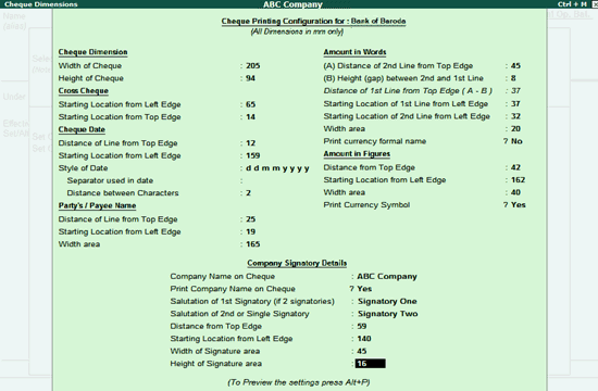

o Enter the cheque dimensions manually or press Ctrl + C to copy the predefined dimensions. The completed Cheque Dimensions screen appears as shown:
o Press Enter to save and return to ledger creation screen.
