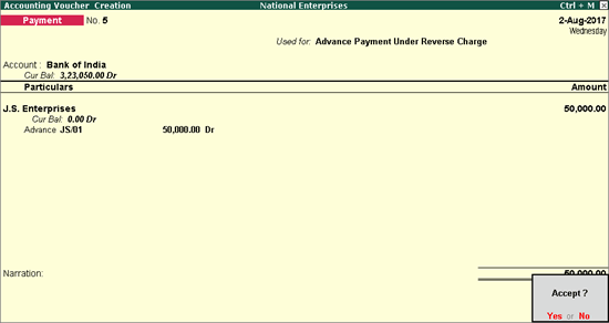

Recording an advance payment to unregistered dealer
When you make an advance payment to an unregistered dealer for goods due to be received on a future date, you can record an advance payment voucher.
To record an advance payment
1.    Go to Gateway of Tally > Accounting Vouchers > F5: Payment.
2.    Click V: Reverse Chrg. Adv. to mark the voucher for advance payment. The values entered in this voucher are captured in GSTR-2 report.
Note: Payment vouchers recorded without clicking V: Reverse Chrg. Adv. will not have GST implications, and will form part of the Summary of Excluded Vouchers.
3.    In Account, select the bank from which the payment will be made.
4.    Select the party ledger predefined as unregistered dealer, and enter the details in the Advance Payment Details screen.
If the stock item being purchased from unregistered dealer does not attract reverse charge, do not configure the stock item for reverse charge. Select the ledger configured for reverse charge in the Advance Payment Details screen.
Note: To categorise and display the stock item or ledgers attracting reverse charge in the Advance Payment Details screen, set the option Enable reverse charge calculation? to Yes in the Configuration screen of GST Details screen (displayed on enabling the option Set/alter GST details? in the stock item or ledger master).
The tax type appears as integrated tax or central tax and state tax, based on the state selected for the party ledger.
5.    Press Ctrl+A to save the Advance Payment Details screen.
6.    Select the type of reference as Advance and enter the reference details in the Bill-wise Details screen.
7.    Enter the details in the Bank Allocations screen.
8.    Press Enter to save.
