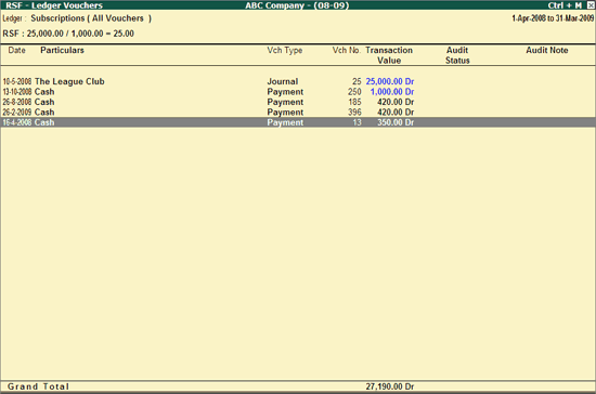

The Ledger Vouchers report for the Relative Size Factor (RSF) report displays the Vouchers for the selected Ledger along with the RSF computation details.
1.    Go to Gateway of Tally > Audit & Compliance > Audit & Analysis > Relative Size Factor (RSF).
2.    Select the required Ledger and press Enter.
The Ledger Vouchers screen displays all the transactions for the respective Ledger. The highest and second highest transaction values are shown in blue colour for clear identification.
The Computation for the Relative Size Factor (RSF) is also shown on top of the screen.

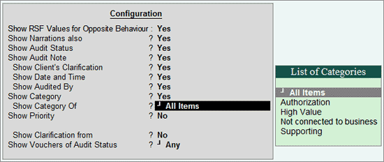

F12: Configure
Click F12: Configure or press F12  to default view to see additional information.
●     Show RSF Values for Opposite Behaviour: Set this option to Yes to display the RSF for transactions with both Credit and Debit values.
●     Show Narrations also: Set this to Yes option to view the Vouchers along with their respective narration.
●     Show Audit Status: Set this option to Yes to view the Vouchers alongside the respective Audit Status (On Hold/Audited/Internal Observation/External Observation).
●     Show Audit Note: Set this option to Yes to view the Vouchers along with their respective Audit Note.
●     Show Client's Clarification: Set this option to Yes to view the Clarification provided by the client for Vouchers that have been marked for Internal Observation/External Clarification.
●     Show Date and Time: Set this option to Yes to view the date on which, and time at which, clarification was provided for the listed Vouchers.
●     Show Audited By: Set this option to Yes to view the person who has performed auditing on the Vouchers.
●     Show Category: Set this option to Yes to view the category of clarification alongside the Vouchers.

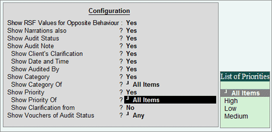

●     Show Category Of: Select the Audit Category and Vouchers marked for the chosen Category will be filtered for display.
●     Show Priority: Set this option to Yes to view the Priority of the clarification required (High/Medium/Low).
●     Show Clarification from: Set this option to Yes to view the user who has provided clarification, if any, for the Vouchers
