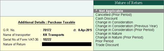

9. Set the option Provide VAT Details to Yes .
10. Enter the purchase details and select the Nature of Return as Not Applicable to account for purchase returns as shown below:
If the debit note is being recorded for any other purpose, select the relevant Nature of Return .

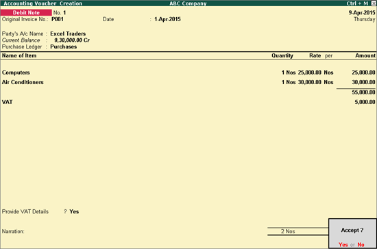

11. Select the required Nature of Return and press Enter . The debit note appears as shown below:
12. Press Enter to save.
