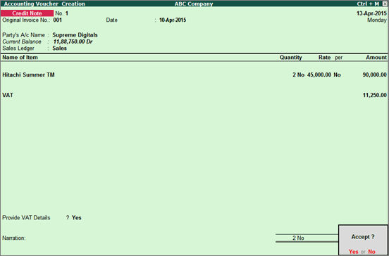

A credit note is recorded against the original sales invoice to record a Sales Return.
1. Go to Gateway of Tally > Accounting Vouchers > Ctrl+F8 .
2. Enter the reference number in the Ref. field.
3. Select the Party’s A/c Name from the List of Ledger Accounts .
5. Select the common sales ledger in Sales Ledger field.
6. Select the required taxable stock item.
7. Enter the Quantity and Rate .
9. Set the option Provide VAT Details? to Yes .
10. Select the Nature of Return .
11. Enter Narration , if required.
12. Press Enter to save.
