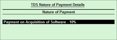

To create nature of payment for taxable purchase of software product
1. Go to Gateway of Tally > Accounts Info. > Statutory Info. > TDS Nature of Pymts > Create .
2. Enter the Name of the nature of payment.
3. Enter 194J and 94J in the fields Section and Payment Code , respectively.
4. Set the option Is software royalty? to Yes .
5. Enter the Rate of tax .
6. Enter the amount up to which tax is not applicable for this category, in the field Threshold/exemption limit , if any.
7. Press Enter to save.

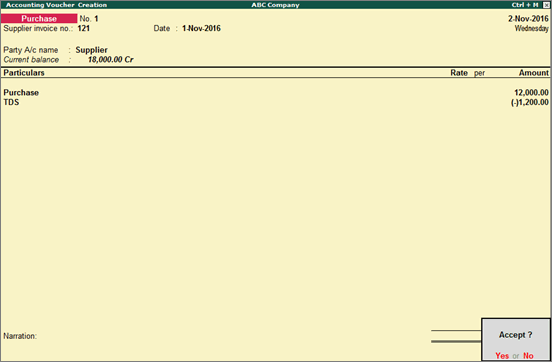

To record taxable purchase of software product
2. Click I : Accounting Invoice to record the invoice in accounting mode.
3. Click F12: Configure .
o Enable the option Allow modifications of Tax Details for TDS?
o Press Ctrl+A to accept.
4. Enter the Supplier invoice no. and Date .
5. Select the ledger of the supplier in the field Party A/c name .
6. Select the ledger, created under Purchase Accounts , under Particulars , and enter the Amount .
7. Press Enter . The Expense Allocation screen appears.
o Select the nature of payment applicable for taxable purchase of software product and press Enter .
8. Select TDS tax ledger under Particulars . The TDS tax amount automatically appears, based on the rate of tax defined in the nature of payment.
9. Press Enter .
10. Enter Narration , if any.
11. Press Enter to save.

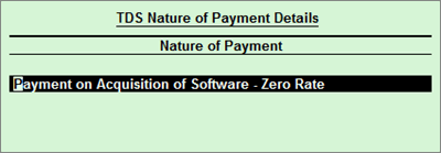

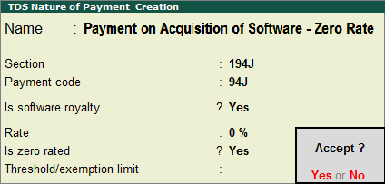

To create a nature of payment for the exempt purchase of software product
5. Enter the Rate of tax as 0% .
6. Set the option Is zero rated? to Yes .
7. Enter the amount up to which tax should not be applied for this category in the field Threshold/exemption limit , if any.
8. Press Enter to save.

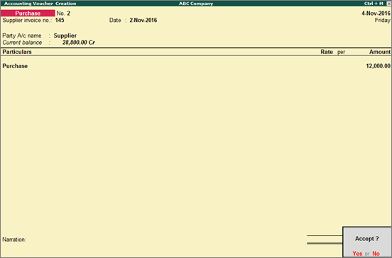

6. Select ledger, created under Purchase Accounts , under Particulars and enter the Amount .
o Select the nature of payment applicable for zero rated purchase of software product and press Enter .
8. Press Enter .
9. Enter Narration , if any.
10. Press Enter to save.

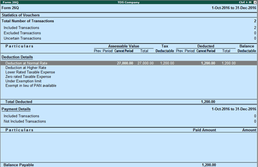

The value from both taxable and exempt transactions will be updated in Form 26Q. However, in the returns file, the value from exempt transaction is flagged with the initial S , indicating software purchase.
