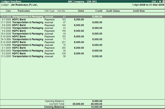

The Ledger Vouchers for the Repeated Transactions report displays those Vouchers for which the amount is repeated more than once.
1. Go to Gateway of Tally > Audit & Compliance > Audit & Analysis > Repeated Transactions .
2. Select the required Ledger and press Enter .
The Ledger Vouchers report displays the Vouchers for which the same amount is repeated along with the other required information like Voucher Date , Particulars , Voucher Type , Voucher Number , Dr and Cr Amounts , Audit Status and Audit Note .
