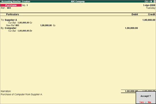

In the normal scenario when a Purchase voucher is entered, only the Ledgers created under Purchase Accounts are displayed for selection.  In certain cases if the user would like to pass the Expenses incurred or Fixed Assets purchase through a Purchase voucher which are normally entered using Journal voucher, the same is possible by enabling the option Allow Expenses/Fixed Assets in Purchase Vouchers in F12: Configure ( Voucher Entry Configuration) in voucher mode.
For Example, pass a purchase entry towards purchase of Computers from Supplier A.
●      Debit Computer Account (Grouped under Fixed Assets).
●      Credit Supplier A Account.
