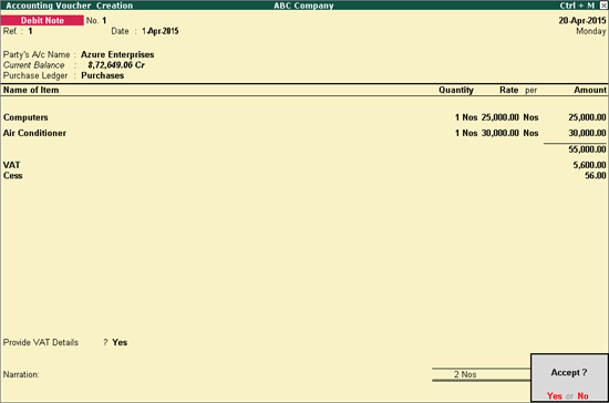

To create a debit note
1.     Go to Gateway of Tally > Accounting Vouchers > Crl+F9.
2.     Enter the reference number and Date of the purchase invoice against which debit note is recorded.
3.     Select the required Party’s A/c Name from the List of Ledger Accounts.
5.     Select the common purchase ledger.
6.     Select the required taxable stock items.
7.     Enter the Quantity and Rate. The amount is automatically displayed in the Amount field.
8.     Select the required common VAT ledger.
9.     Select the common cess ledger.
10.  Set the option Provide VAT Details to Yes.
11.  Select the Nature of Return based on the transaction being recorded. In case of purchase returns, select Not Applicable. The Statutory Details screen appears as shown below:
12.  Enter the credit note number and date as specified in the credit note received from supplier. The debit note appears as shown below:
13.  Press Enter to save.
