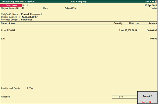

A debit note is created to against the original invoice to record the purchase returns
1.     Go to Gateway of Tally > Accounting Vouchers > Ctrl+F9.
2.     Enter the reference number in the Ref. field.
3.     Select the required Party’s A/c Name from the List of Ledger Accounts.
5.     Select the common purchase ledger.
6.     Select the required taxable stock items.
7.     Enter the returned Quantity and Rate. The amount is automatically displayed in the Amount field.
8.     Select the required common VAT ledger.
9.     Set the option Provide VAT Details? to Yes.
10.  Select the Nature of Return.
11.  Enter Narration, if required.
12.  Press Enter to save.
