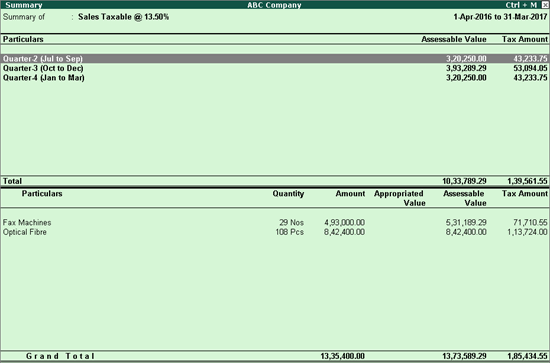

2.     Press Enter from any row displayed in italics, under Local Sales or Interstate Sales to display the Summary screen with quarter-wise sales value for selected VAT rate.
The Summary screen appears as shown below:
Similarly, quarter-wise sales value for other VAT rate can be displayed by drilling down from respective VAT rate row in the report.
Drill down from any quarter to view item-wise sales details for the quarter.

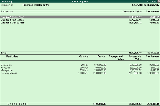

2.     Press Enter from any row displayed in italics, under Local Purchases or Interstate Purchases to display the Summary screen with quarter-wise purchase value for selected VAT rate.
Similarly, quarter-wise purchase value for other VAT rate can be displayed by drilling down VAT rate row in the report.
Drill down from any quarter to view item-wise purchase details for the quarter.

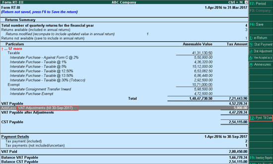

In Form RT-III, only the adjustment transactions recorded for the financial year are considered. These adjustment transactions should be recorded within the annual return filing date. The annual return filing date for Form 205 can be set using the Pay. Till Date button in the report and is displayed as shown below:
VAT payments and adjustments for the annual return can be recorded within this set period.

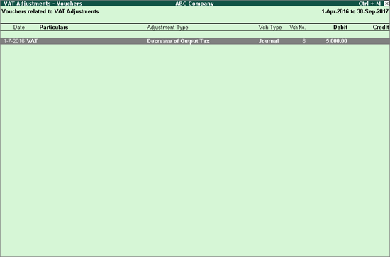

Adjustment transaction for annual return are recorded by selecting the entire financial year as the period in the Statutory Details screen of the journal voucher. Drill down from VAT Adjustments row to display the list of adjustment transactions recorded for annual return.
