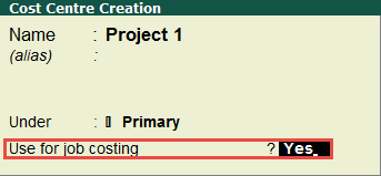

To enable Job Costing in Cost Centres
1.     Go to Gateway of Tally > Accounts Info > Cost Centres > Create.
2.     Enter the Name of the cost centre.
3.     Select Primary or the required cost centre in the field Under.
4.     Set the option Use for Job Costing to Yes.
The  Cost Centre Creation screen appears as shown below:
5.     Press Enter.
6.     Press Enter to save the cost centre.
