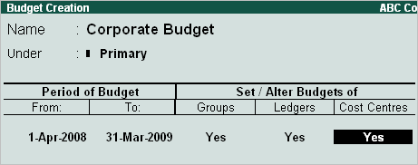

1.     Go to Gateway of Tally > Accounts Info. > Budgets > Create.
2.     In the Budget Creation screen, enter a Name for your budget.
3.     Enable budgets for groups, and ledgers if required.
4.     Set the option Cost Centres to Yes to view the Cost Centre Budget screen.

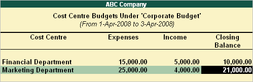

5.     Enter a budget figure in Expenses for the cost centre.
6.     Enter a budget figure in Income for the cost centre.
7.     Enter Closing Balance.
The Cost Centre Budget screen appears as shown below:
8.     Press Enter.
9.     Press Enter to save the budgets created.
