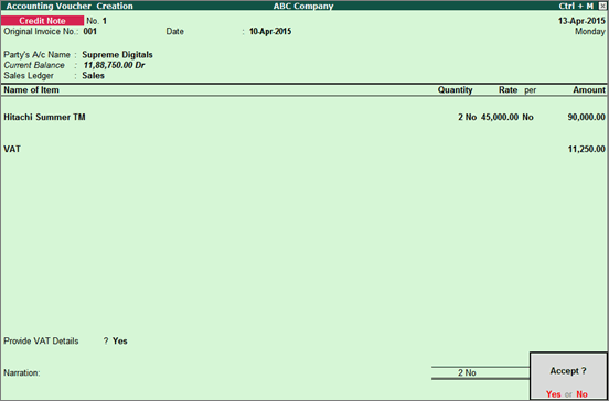

A credit note is recorded against the original sales invoice to record a Sales Return.
1.     Go to Gateway of Tally > Accounting Vouchers > Ctrl+F8.
2.     Enter the reference number in the Ref. field.
3.     Select the Party’s A/c Name from the List of Ledger Accounts.
5.     Select the common sales ledger in Sales Ledger field.
6.     Select the required taxable stock item.
7.     Enter the Quantity and Rate.
8.     Select the required common VAT ledger.
9.     Set the option Provide VAT Details? to Yes.
10.  Select the Nature of Return.
11.  Enter Narration, if required.
12.  Press Enter to save.
