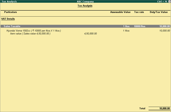

To record local sales of pre-owned cars
1.     Go to Gateway of Tally > Accounting Vouchers > F8: Sales.
2.     Enter Ref number, if required.
3.     Select the party ledger in Party's A/c Name option.
4.     Select a common sales ledger in which the option Is VAT/CST Applicable is set to Applicable, and Set/Alter VAT Details is disabled.
5.     Select the required stock items (Pre-owned cars) with the following settings:
●      Calculation Type set as On Quantity.
●      Tax rate specified as 3,000 or 10,000 as per the engine capacity of the pre-owned car.
●      Tax type set as Taxable.
6.     Select the common VAT ledger.
7.     Click A: Tax Analysis to display the Tax Analysis screen.
8.     Click F1: Detailed to view the names of stock items. The Tax Analysis screen appears as shown below:
9.     Press Esc to return to tax invoice
The tax invoice appears as shown below:
