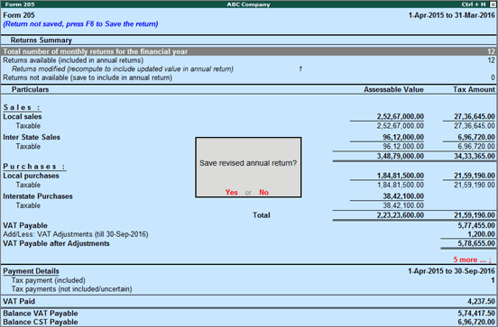

When periodic returns are modified, recomputed, overwritten or saved, the annual return has to be recomputed before overwriting or saving as revised to update the values modified.
To recompute the changes made and save as revised,
1.     Click F5: Recompute. The buttons F6: Overwrite and F7: Save as Revised appear once the return is recomputed.
2.     Click F7: Save as Revised to overwrite the existing return details with modified details. A confirmation message appears as shown below:
3.     Click Yes to save the return as revised.
