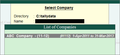

1.     Go to Gateway of Tally > Company Info > Select Company.
2.     Select the company to be audited from the List of Companies.

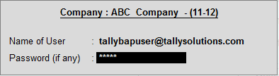

o      Press Enter to display the Company Login screen.
o      Provide the BAP Username (or sub-user) and Password in the Company Login screen.
o      Press Enter to Load the Company.
