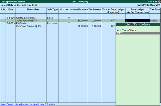

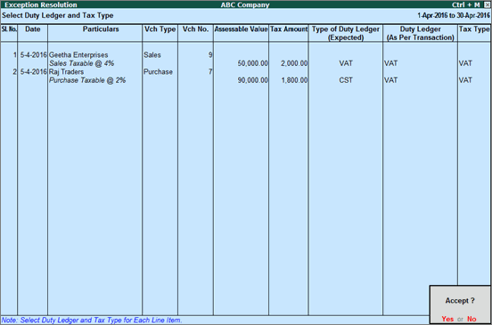

Incorrect tax type selected in tax ledger: Displays count of transactions in which type of duty is invalid.

Information required for generating annexure not provided: Displays the count of transactions excluded from annexures due to incomplete information required for annexures. The button Exception Types is provided to resolve all party ledger level or voucher level corrections from a single screen.
●      Exception Types: Using this option you can resolve exceptions from a common screen by grouping all annexure related exceptions into two buckets Party Ledger level Corrections and Voucher Level Corrections. Exceptions in each group can be resolved from a single screen without having to move voucher by voucher.
Drill-down from any row and resolve the respective exceptions to include the vouchers in return and annexure.
