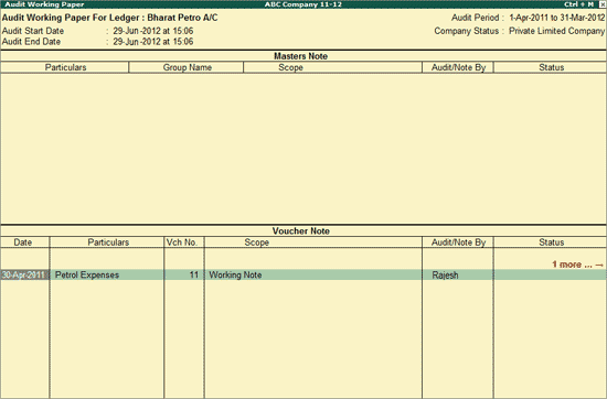

Click W: Working Note or press Alt+W to specify the working note details at Company or Group or Ledger or Voucher level. The details provided in working note will be captured in Audit Working Paper along  with the details of User Name, Working Note Date and Time, Status, Note and so on.
Ctrl+W: Audit Wkg Paper
For more details on Working Paper refer the topic Audit Working Paper.
