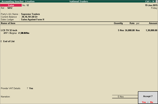

6.     Set the option Provide VAT Details to Yes to view the Statutory Details screen. In the Statutory Details screen,
o      Enter H Form details. The Statutory Details screen appears as shown below:
o      Press Ctrl+A to accept, and  return to sales invoice.
The tax invoice appears as shown below:
7.     Press Enter to save.
