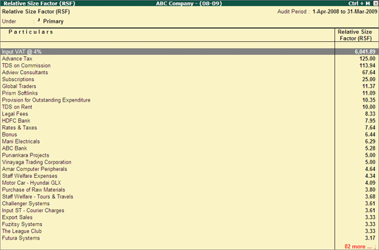

The new report will compare the Highest Value transactions for each Ledger Vouchers to the Second Highest Value and displays the Relative Size Factor which can lead into further investigation to correct the above mistakes.
To view the Relative Size Factor report
1.     Go to Gateway of Tally > Audit & Compliance > Audit & Analysis > Relative Size Factor (RSF).

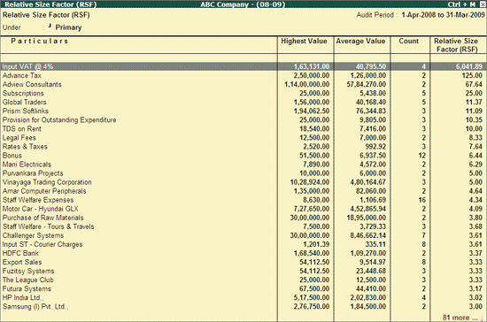

The Relative Size Factor report displays the Ledger wise RSF value as shown above. The Auditor can drill down from the above report to view the details of the Ledger Vouchers where the details of the Relative Size Factor computation can be viewed.
The configured Relative Size Factor report is displayed as shown:
The Relative Size Factor report displays the Ledger wise Highest, Average and RSF Value along with the count of vouchers as shown above. The Auditor can drill down from the above report to view the details of the Ledger Vouchers where the details of the Relative Size Factor computation can be viewed.
Note: Average Value will be calculated by considering the total of the ledger divided by the number of transactions of that ledger.

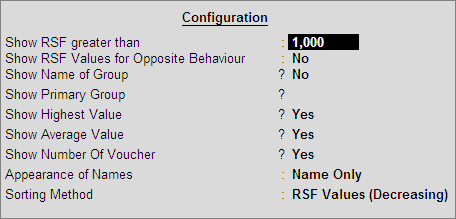

F12: Configure
      Show RSF greater than: Specify the value to view the report for RSF greater than mentioned in this field.
Note: In the above screen, all the Vouchers where total amount is greater than 1000 will be displayed in the report once the configuration is saved.
      Show RSF Values for Opposite Behaviour: Set this option to Yes to view the RSF for transactions having either Debit or Credit balance also.
      Show Name of Group: Set this option to Yes to display the name of the immediate Group/Subgroup.
      Show Primary Group: Set this option to Yes to display the name of the Primary Group.
      Show Highest Value: Set this option to Yes to display the Highest Value Transaction for each Ledger.
      Show Average Value: Set this option to Yes to display the Average Value Transaction for each Ledger.
      Show Number of Vouchers: Set this option to Yes to display the count of the vouchers for each Ledger.
      Appearance of Names: Select the required Display Name for the Ledgers.
      Sorting Method: Select the required sorting methods from RSF values increasing/decreasing, alphabetical increasing/decreasing or default method.
