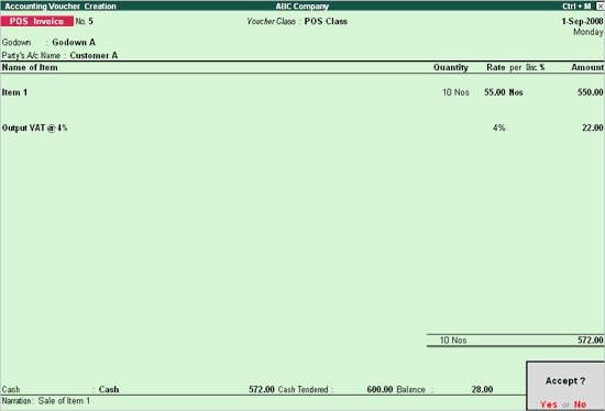

A POS  transaction is recorded using the PoS Invoice Voucher Type created.
To record a POS transaction
1.     Go to Gateway of Tally > Accounting Vouchers > F8: Sales to view the Change Voucher Type screen.
2.     Select POS Invoice as the Voucher type.
3.     Select the Godown, as required.
4.     Select the Party's A/c Name, as required.
5.     Select the Sales Ledger, as required.
6.     Select the Name of Item or create a new stock item.
7.     Set the Rate of the item, as required.
8.     Select VAT/Tax ledger from the list of Ledger Accounts.
The Accounting Voucher screen appears as shown below:
9.     Press Enter to save.
Note: POS invoices can be recorded with different actual and billed quantities by enabling the option  Use separate actual and billed quantities in F11 (Features) > F2(Inventory).
