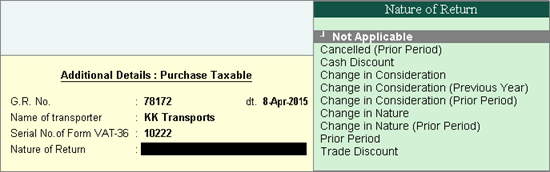

10.  Enter the purchase details and select the Nature of Return as Not Applicable to account for purchase returns as shown below:
If the debit note is being recorded for any other purpose, select the relevant Nature of Return.

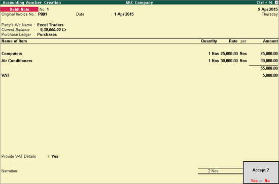

11.  Select the required Nature of Return and press Enter. The debit note appears as shown below:
12.  Press Enter to save.
