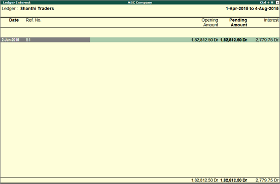

Viewing Interest on Outstanding Balances
To view the report on Outstanding balances
1.     Go to Gateway of Tally > Display > Statements of Accounts > Interest Calculations > Ledgers
2.     Select the required ledger. The Ledger Interest report appears as shown below:

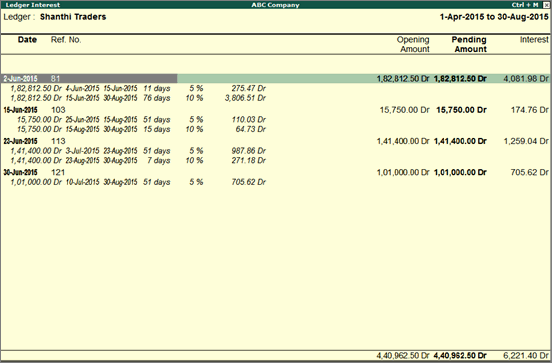

3.     Click F1: Detailed to view the calculation and period.
Note: In case if part of the amount is settled, the interest is calculated on the remaining balance.
