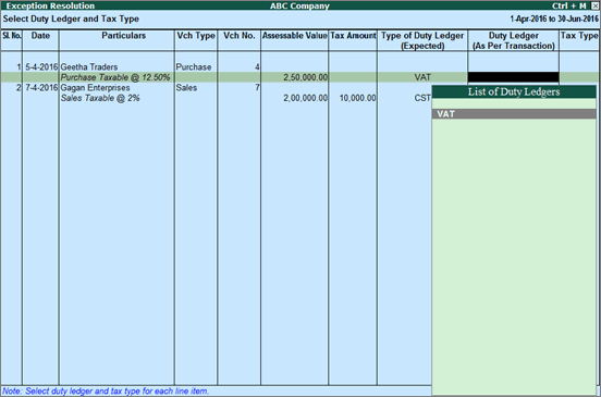

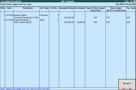

Incorrect tax type selected in tax ledger: Displays count of transactions in which type of duty is invalid.
To resolve this exception
1. Select the exception Incorrect tax type selected in tax ledger.
2. Press Enter. All the transactions of the exception type are displayed, as shown below:
3. Select the tax type for each transaction.
The Exception Resolution screen appears as shown below:
4. Press Enter to save.
