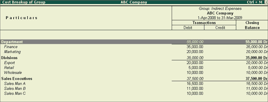

The Group break-up of cost centre gives you another view of a cost centre report by enabling you to analyse the distribution of a group (of ledger accounts) across different cost centres.
This report helps to display the breakup of Indirect Expenses under each cost centre.
1.     Go to Gateway of Tally > Display > Statements of Accounts > Cost Centres > Group Break -up
2.     Select a group account, say for example, Indirect Expenses. The Group Break-up screen is displayed as shown below:
The total Indirect Expenses allocated to different Cost Centres under different Cost categories are given. If you have only one category, it will be listed under this category.

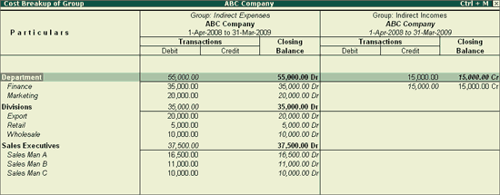

Use New Column to bring up another group of ledger account, say, Indirect Income. You will be able to judge their relative performance or even compare the data with that of another company.
