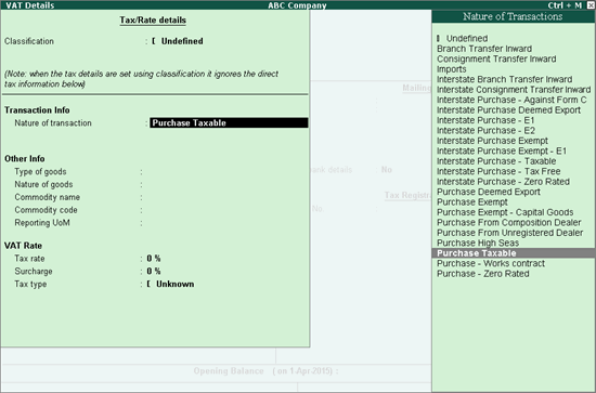

To create a ledger defined with Nature of Transaction and tax rate
1.     Follow the first five steps provided for creating common purchase ledger.
2.     Enable the option Set/alter VAT Details?.
o      Set the Classification option in VAT Details, as required.
o      Select the  Nature of Transaction. Click F12:Configure to enable more options.
o      Select the Type of goods and Nature of goods.
o      Enter the Commodity Name and Commodity code.
o      Select the required Reporting UoM.
o      Enter the Tax rate and Surcharge.
o      Select the required Tax type.
The VAT Details screen appears as shown below:
o      Press Enter to save the VAT Details screen.
3.     Press Enter to save.
1.     Follow the first five steps provided for creating common sales ledger.
2.     Enable the option Set/alter VAT Details.
o      Set the Classification option in VAT Details screen to:

The VAT Details screen with Local VAT rate appears as shown below:
