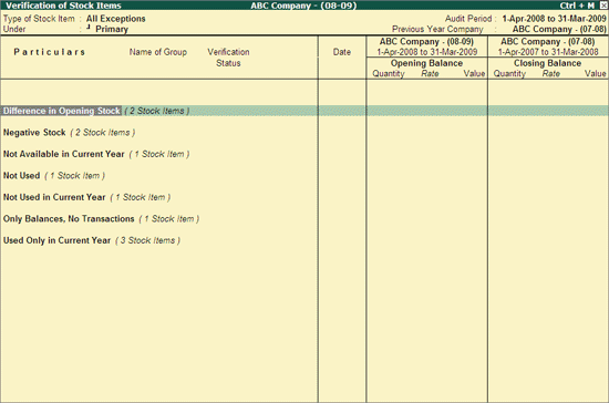

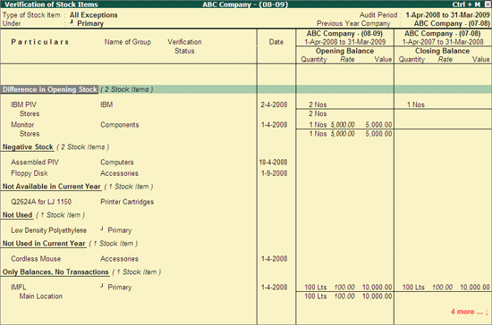

The Verification of Stock Items reports classifies and displays all the exceptional Stock Items (All Exceptions) along with the Item Count under the following exception status:
Only Balances, No Transactions
Stock Items that have only Balances, but have not been used for recording transactions during both the years will be displayed under this status.
Not Used
Stock Items which do not have any balance and have not been used in recording any transaction during both the years will be displayed under this status.

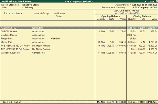

Negative Stock
Stock Items with negative Closing Balance at the end of the Current Year (Audit Year) will be displayed under this status.
Used Only in Current Year
Stock Items (with or without Opening Balance) that have been used to record transactions only in the Current Year will be displayed under this status.
Difference in Opening Stock
Stock Items with difference in Opening Stock from Previous Year and Current Year will be listed under this status.
Not Used in Current Year
Stock Items which have been used for recording transactions only in the previous year, have no Closing Balance (from the previous year), and have no Opening Balance in the current year will be listed under this status.
Not Available in Current Year
Stock Items that have been discontinued (not present) in the current year will be listed under this status.

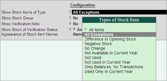

The other Status which can be viewed using the F12: Configure are:
All Items
Displays all the Stock Items irrespective of the status.
No Change
Displays the Stock Items which are used in both the Years.

F1: Detailed
Click on F1: Detailed or press Alt+F1 to view the list of Stock Items under the selected status.
Detailed screen for All Exceptions status is shown below:

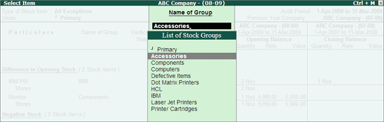

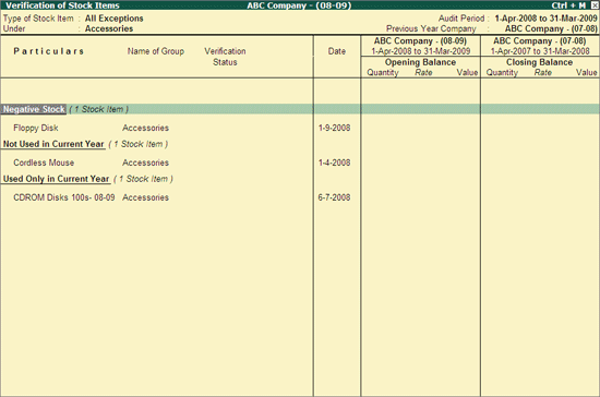

F4: Group
Click on F4: Group or press F4 to filter the Stock Items belonging to a particular Group.
●      Select the required Group from the list of Stock Groups and press Enter.

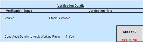

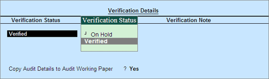

F9: Verify
Click F9: Verify or press F9 to mark any Stock Item as On Hold or Verified.
Note: The facility to mark a Stock Items as Verified is provided only for those Stock Items which are present in the Audit Year.
In Verification Details screen:
●      In Verification Status field select the required status - On Hold or Verified.
●      Enter the required remarks in the Verification Note.
●      By default, the option Copy Verification Details to Working Paper will be set to Yes. Once the Verification Details are saved, the details will be captured in Working Paper.
Note: The option Copy Verification Details to Working Paper will be displayed in Verification Details screen only when the  Working Paper is enabled in F11: Accounting Features.

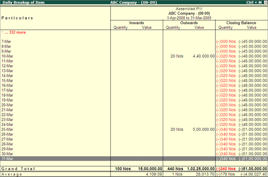

N: Dly Negative Stock
Click N: Dly Negative Stock or press Alt+N to display the list of stock items having negative stock on any Day during the audit period.
Verification of Stock Items - Negative Stock report, the user can drill down to the Daily Breakup for Stock Item  to view the Negative stock report of each day during the audit year.
●      Press F6: Dly Brk-up or press F6 to view daily breakup of Negative Stock.
The Daily Breakup for Stock Item is displayed as shown below:

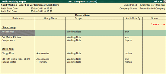

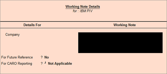

W: Working Note

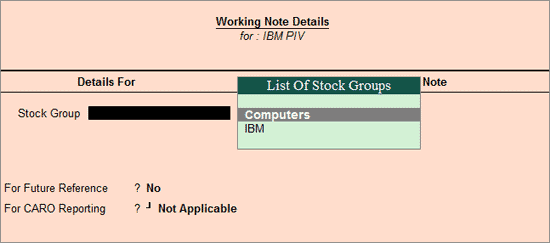

Click W: Working Note or press Alt+W to specify the working note details at Company or Stock Group or Stock Item level. The details provided in working note will be captured in Audit Working Paper along with the details of User Name, Working Note Date & Time, Status, Note and so on.
●      Details for: In this field select the level for which Working Note to be entered.
●      Company: On selection of Company as the Level cursor will move to Working Note field to enter the details.
●      Stock Group: On selection of Stock Group based on the ledger selected, displays the list of Groups for defining the Working Note.
●      Stock Item : Selection of level - Stock Item, application will default the stock item for which the Working Note to be entered.

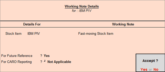

●      Working Note: In this field enter the working note details.
●      For CARO Reporting?: Choose the clause applicable to the Working Note from the list of CARO Clauses displayed. Working Notes tagged with CARO Clauses will appear in the CARO Working Paper.
●      For Future Reference?: By default this option will be set to No. Set the option to Yes, to carry the Working Note forward to the next audit period. That is, the Working Note details will be displayed in Audit Working Paper of Current as well as Next Audit Period.
Ctrl+W: Audit Wkg Paper
To view the Audit Working Paper during Auditing, click on Ctrl+W: Audit Wkg Paper or press Ctrl+W. The details displayed in Audit Working Paper will be relevant to report from where it is triggered.
For more details on Working Paper refer the topic Working Paper.

●      Show Stock Items of Type: Select the required Types of Exception from the list to display the Stock Items belonging to the selected status.

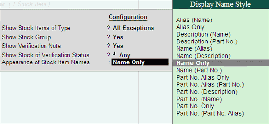

●      Appearance of Stock Item Names: Select the required Display Name for the Stock Items from the list of Display Name Style as shown:

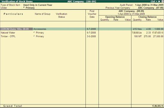

The Verification of Stock Items report for the Items Used Only in Current Year is displayed below:
Note: The above report is same when option Show Stock Items of Type is selected as Used Only in Current Year in the F12: Configuration.
The Auditor can press Enter on any of the selected Stock Items to view the Stock Vouchers report.
