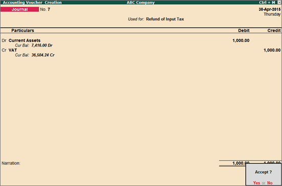

4. Credit the VAT ledger. Enter the tax Rate, and Assessable Value in the VAT Details screen.
The journal voucher appears as shown below:
5. Enter Narration, if required.
6. Press Enter to save.
