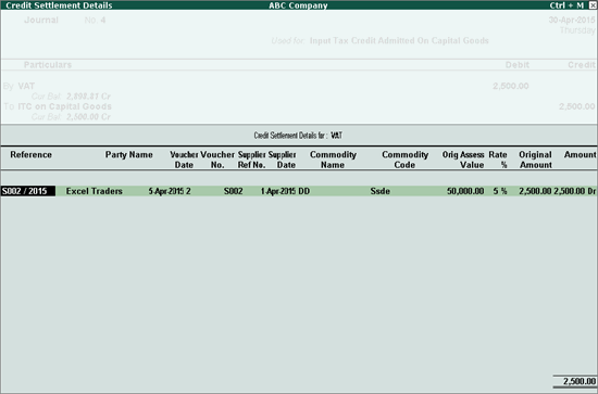

6.     Debit a VAT ledger created under the group Duties and Taxes by enabling the option Use for Purchase Tax? after selecting Type of duty/tax as VAT. The Credit Settlement Screen is displayed.
7.     Credit the ledger created under the group Current Assets and enter the value in the Amount field. The completed transaction screen appears as shown below:
8.     Press Enter to save.
