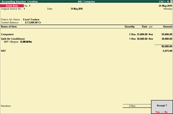

The debit note screen appears as shown below:
9.     Press Enter to save.
