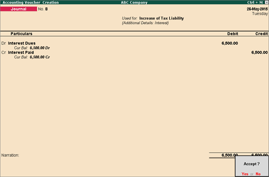

4. Debit an expense ledger created under Indirect Expenses with option Is VAT/CST Applicable? set to Not Applicable.
5. Credit the ledger created under Current Liabilities. The completed screen appears as shown below:
6. Press Enter to save.
