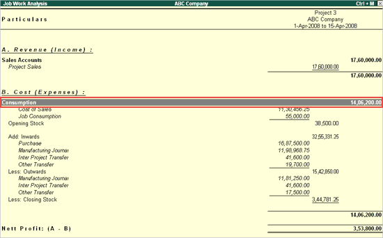

To view the Material Consumption Summary report
1.     Go to Gateway of Tally > Display > Statement of Inventory > Job Work Analysis.
2.     Press Enter in the field Consumption to drill down.

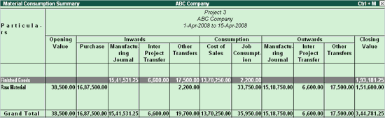

The Material Consumption Summary report is displayed as shown below:

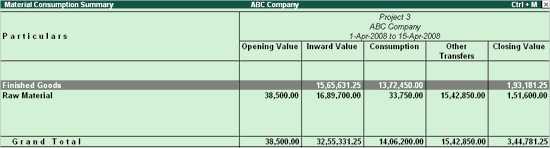

Configuring Material Consumption Summary

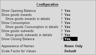

To configure the report
1.     Click F12: Configure.
2.     Enable the following options:
●      Show goods inwards
●      Show goods inwards in details
●      Show consumption
●      Show goods consumption in details
The detailed Material Consumption Summary will appear as shown below:

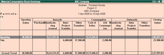

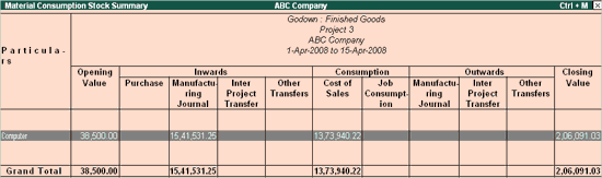

Press Enter on a row to drill down to the Material Consumption Stock Summary report.
The Material Consumption Stock Summary report appears as shown below:
Field
Description
Particulars
The stock items consumed for the project selected in the Job  Work Analysis report are displayed here.
Inwards
Purchase
The value of the stock item purchased for the project is displayed here.
Manufacturing Journal
The value of the stock item produced by recording a Manufacturing Journal in which the godown has the selected project tagged.
Inter Project Transfer
The value of the stock items recorded in a stock journal class for transfer of goods (Use Class for Inter-Godown Transfers is enabled), and in which the godown has the selected project tagged.
Other Transfers
The value of the stock items recorded in a stock journal without using any voucher class but in which the godown has the selected project tagged.
Consumption
Cost of Sales
The value of sales recorded in an item invoice is displayed here.
Job Consumption
The value of stock items recorded in a stock journal using a Consumption Class and in which the godown has the selected project tagged.
Outwards
The value of transactions recorded using a manufacturing journal is recorded here.
Other Transfers
Closing Stock
Closing Stock
 The value of Opening Value + Inwards - Consumption - Other Transfers
Drill down from the above report, will display the stock items used for Job/Project

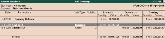

1.     Press Enter on any field in the Consumption section of the report to drill down to the Material Consumption Summary.
2.     Press Enter from the Material Consumption Summary to view the Material Consumption Stock Summary.
3.     Drill down further to display the Godown Voucher screens.

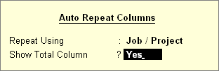

To view total material consumption of all jobs or projects
1.     Click N: Auto Column.
2.     Select Job/Projects in the field Repeat Using.
3.     Set the option Show Total Column to Yes.

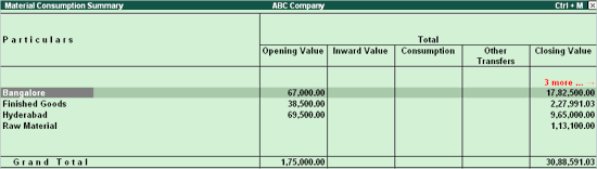

The Material Consumption Summary appears as shown below:
Note: Click N:New Column and select another project for comparison.
