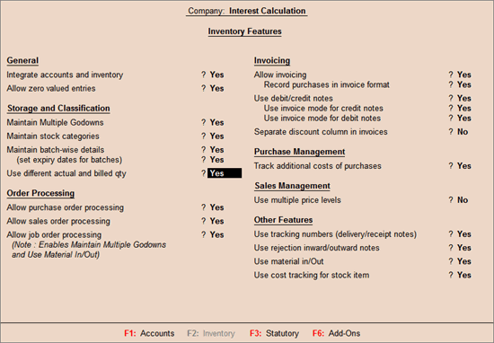

Set the option Use different Actual and Billed Qty to Yes in F11:Features:F2:Inventory Features.

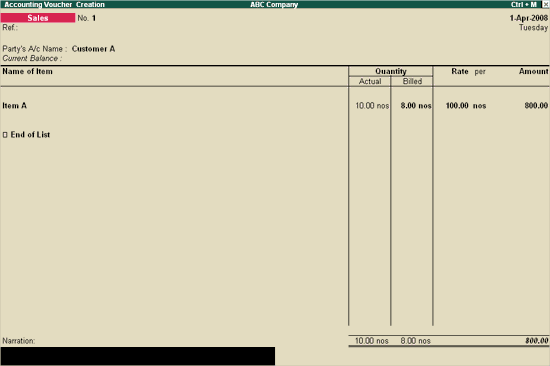

Purchase or Sales vouchers with Actual and Billed quantity will appear as shown.
In the screen shown above, there are two columns under Quantity:
  • Actual
  • Billed
Once when quantities are entered under Actual and Billed, stocks will be reduced to the extent of Actual quantities only.
Example:
A company gives 2 items free as a sample to the customer, when 10 items are purchased. Then under Actual qty column 10 numbers will be entered and under Billed quantity 8 numbers will be entered. In the stock summary 10 numbers will be shown under Outwards.
