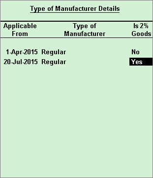

Enabling 'as Manufacturer of only 2% goods'
If your business involves dealing with only goods taxable at 2%, then provision can be made to set this during excise registration.
To configure as a manufacturer of only 2% goods,
  1. Click F12: Configure from the Excise registration details screen.
  2. Enable the option Enable as manufacturer of only 2% goods.
  3. Press Ctrl+A.
  4. Enable the option Deals with only 2% Goods.
  5. Click L: Details to define the date of applicability for dealing with 2% goods.
  6. Enter the date in the field Applicable from.
  7. Select the Type of Manufacturer.
  8. Select Yes in the field Is 2% Goods.
  1. Set applicability details for the next period, if required.
  1. Press Enter to go to the Excise registration details screen.
