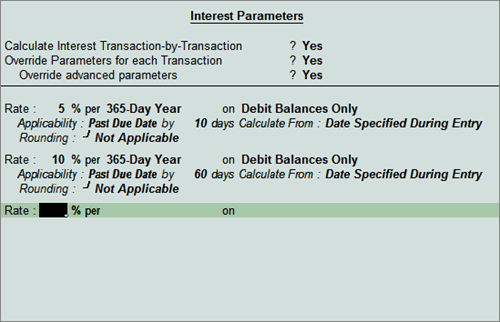

To set advanced configuration in Interest Parameters screen of party ledger master
1.     Set Calculate Interest Transaction-by-Transaction? to Yes to calculate interest for each transaction.
2.     Set Override Parameters for each Transaction? to Yes to display the Interest Parameters screen while recording the transaction. The defined parameters can be modified during voucher entry.
3.     Set Override advanced parameters? to Yes.
4.     Enter the Rate of interest.
5.     Select the interest style, as required. The rate of interest will be calculated on the basis of the interest style applied.
6.     Select the balance on which the interest has to be calculated. Interest can be calculated on credit balance, debit balance or both credit and debit balances.
7.     Select the Applicability of the interest as required. If Past Due Date is selected, then the number of days after which interest has to be applied can be specified.
8.     Select the date from which interest is applicable in the Calculate From field.
9.     Select the rounding method applicable in the Rounding field. Select Not Applicable for saving values as is without rounding off.

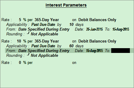

10.  Define multiple slabs with different rates and applicability.
The Interest Parameters screen with multiple slabs appears as shown below:
11.  Press Ctrl+A to accept the configuration.
12.  Press Ctrl+A to save the ledger.
In case of the above configuration, interest will be calculated at 5% starting from 10th day after due date and at 10% starting from 60th day after due date. Similarly, multiple slabs can be configured with different interest style, applicability, calculate from and rounding.

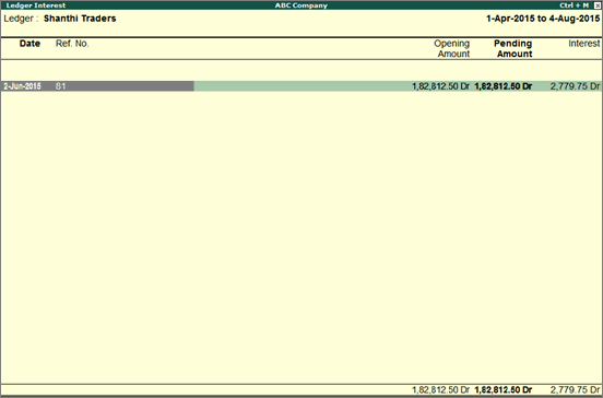

To view the interest amount
●     Go to Gateway of Tally > Display > Statements of Accounts > Interest Calculations > Ledger

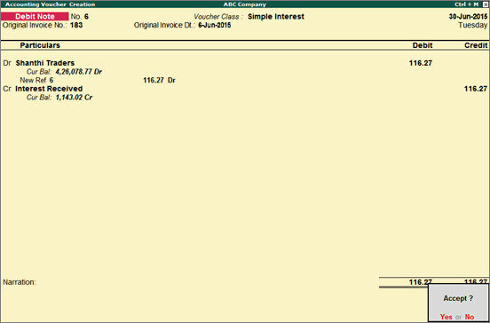

To create a voucher for booking the interest
1.     Go to Gateway of Tally > Accounting Voucher > Crtl+F9: Debit Note
2.     Debit the party ledger

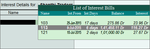

o      Select the bills to adjust from the List of Interest Bills in the Interest Details screen.
o      Press Enter.
3.     Select New Ref in the Bill-wise Details screen.
4.     Credit the ledger Interest Received grouped under Indirect Income.
 The debit note for simple interest appears as shown below:
5.     Press Enter to save.

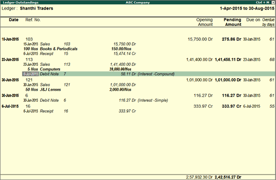

The Ledger Outstandings will be as shown below:
The bill no. 113 is the invoice onto which interest has been compounded.
A new reference no 6 has been created for simple interest due from the party.
