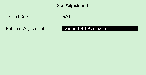

2.     Click J: Stat Adjustment button.
o      Select the option VAT in the Type of Duty/Tax field.
o      Select the option Tax on URD Purchase in the Nature of Adjustment field.
o      Press Enter to return to voucher.

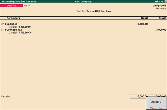

3.     Debit a ledger created under Indirect Expenses and enter the value in the Amount field.
4.     Credit a VAT ledger created under Duties and Taxes by enabling the option Use for Purchase Tax? after selecting Type of duty/tax as VAT.

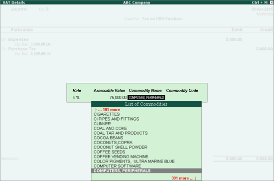

o      Enter the Rate and Assessable Value in the VAT Details screen.
    The completed screen appears as shown below:
5.     Press Enter to save.
