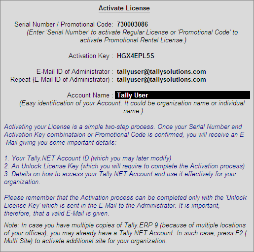

Activating Single Site Account
To activate a single site account
1.     Start Tally.ERP 9.
2.     Click A:Activate License in the Startup screen.
The Activate License form appears as shown below:
3.     Enter the details in the Activate License form, and press Enter. A confirmation message appears on successful activation.
To unlock the license file see, Unlocking License.
Note: The account related information like serial number, activation key, unlock key, and so on is sent to the e-mail ID specified in the Activate License form.

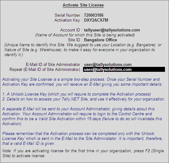

Activating Multi Site Account
To activate the multi site account
3.     Click F2: Multi Site in the Activate License screen.
 The Activate Site License form appears as shown below:
4.     Enter all details in the Activate Site License form, and press Enter.
Note: Use the existing Account ID to activate the new/subsequent sites.
The User Resolution screen to activate a new site appears as shown below:
5.     Click Create a new account or Add to existing account.
●      The option Create a new account creates a new account for the serial number.
●      The option Add to existing account opens the User Resolution screen as shown below. This will add the serial number to an existing account.
6.     Click Create a new Site in the User Resolution screen to create new site with the Site ID specified in the activation screen, or click Reactivate existing Site to reactivate an existing site.
A confirmation message is displayed on successful activation.
Note: The account related information like serial number, activation key, unlock key, and so on is sent to the e-mail ID specified in the Activate Site License form.
